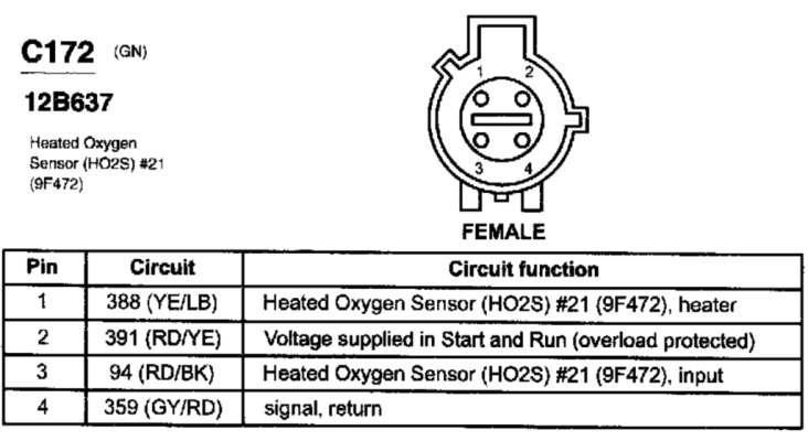

As I researched, I found this thread: https://www.expeditionforum.com/threads/p0059-and-p2197-with-some-diagnostics.55712/
Sanity check 2: As all the faults are with one sensor, all at the same time, I think I should start with checking this connection as shown at the thread above?

Checking the integrity of the wires from connector to connector is a good place to start. Checking the integrity of the PCV tube and elbow(back of intake) is easy and free so may as well check that too. I do agree the PCV is not the likely cause of the O2 sensor issue though.
For the parts question. I have generally found that OEM parts to be the right answer. More of then than not they work and last longer. The premium price is the issue we tend to have with OEM parts. If it's an easy part to replace I'll take the chance sometimes. If I can identify the OEM part manufacturer I will sometimes by the part under their label. Such as the IAC valve that Hitachi made for Motorcraft, I go with the Hitachi for 2/3 of the price.
Go to https://charm.li and down the load service manual for your Expedition. The wiring diagrams and connector views will help tremendously in this troubleshooting adventure. Here's an example.

Everything checked out good for continuity. I bought a new O2 sensor, went with the Bosch, and crawled under it. when I went to remove the original O2 sensor, it was hand tight. It might have just been loose, but I swapped it out anyway and used an anti-seize on the threads. Took it out for a drive and it ran great. Made a couple of stops and by around 60 miles it cleared it's own CEL. My girlfriend and I gassed it back up and took it for a 320 mile ride trip through Summer Lake Hot Springs. We thew a futon mattress in the back and slept under the Oregon Dark Skies stars. Had a great trip. I really like this rig.
