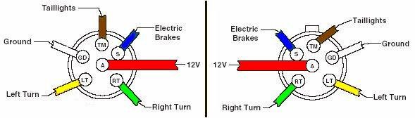

You can bet the Certified Handicap installation business just tapped into the trailer towing harness wiring. There's red hot 12vDC wire in the harness wired to the center pole of the round connection. "Trailer battery charge." Don't have a wiring diagram handy but this connection was ignition controller, not direct to the battery.
