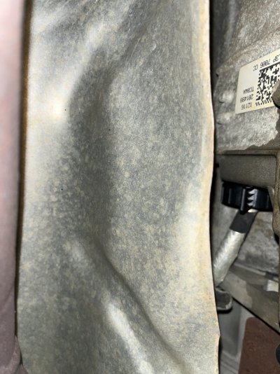

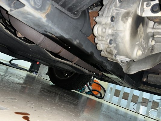

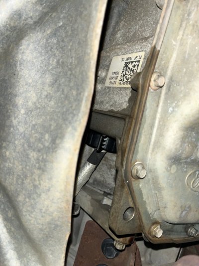

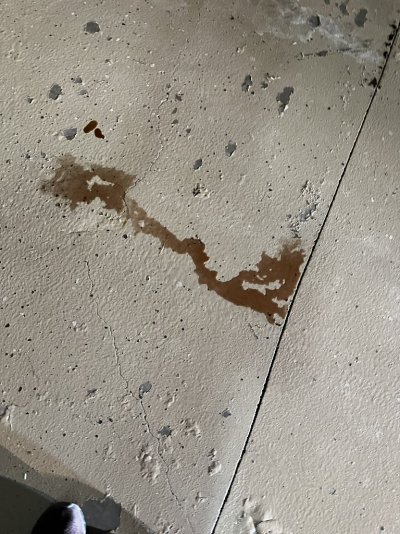

I was away for 10 days and came back to this leak in my garage floor. It looks to be transmission fluid. I do not know if it was there while I was gone or after I drove it the first time today. I just noticed it the second time I came home. I wasn't looking earlier in the day so Im not sure if it was there before I took off or not. Going through a divorce so I don't have a male here to check it out and cant afford Ford right now so Im hoping its something from where it sit so long. Normally I drive this several shorts trips daily all day and there have never been any leaks like this.

The transmission cooling lines are notorious for leaking on the 6-speed transmission and the 3.5 Ecoboost engine (also used in the F-150 truck).
Without putting the vehicle on a lift for inspection, you cannot determine where it is leaking. Fluid leaks can migrate due to wind (while driving) and “move”.
Do NOT drive the vehicle while it is leaking or low on transmission fluid.
