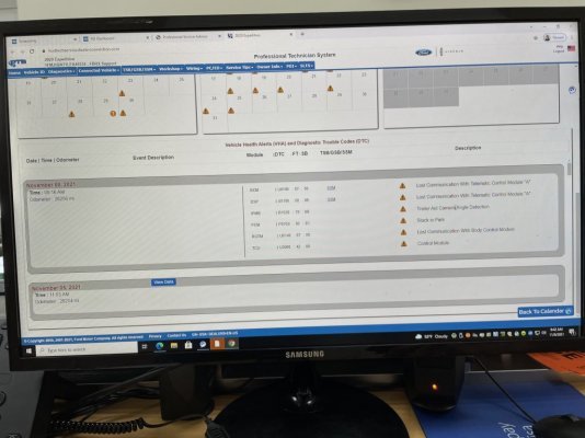

My 18 is in the shop right now for this very issue.
Had other dealer just reset the software and told me to drive it for 500 miles and that the tranny will "fix itself" as it's a learning transmission.
Same problems after the 500 miles: Car shifts harshly out of 1st and every odd gear clunks hard, some more than others and was easy to replicate at the dealer. I also opened a support case with Ford and will know more when they call me back.
