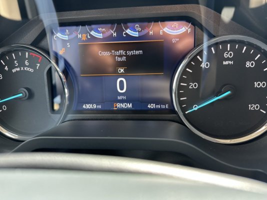

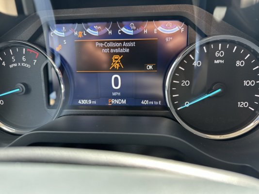

Certainly seems so - Feb is in the rear view mirror, I’m being told “possibly” end of October. When this started in May, my dealer tried to fix it twice then told me the “software update” should be pushed out in July. I have gone thru the nut roll of walking thru resetting everything with guidance of Ford and was told “it may take 4 to 6 weeks for this to work”. Is anyone seeing this when first starting vehicle?
I’m about ready to pull the trigger on the Lemon Law and let Ford deal with my states Consumer Protection Agency.

It is a combination Front camera plus software issue. Ford is unwilling or unable to fix. Dealer reset is the only option once you get the front camera fault. Up till then you can reset with total shut down. Dealer reset has worked for 30-300 miles. I drove Stoneblue for 19,000 miles with no cruise and no safety systems. Ford Corporate did the string along we will fix it a few months down the road, q125, Feb-25, March-25, May-25, July-25 now October-25. My first failure was within 3 days of purchase. If you have three significant dealer fixes that do not work (you safety systems and cruise control are significant) you can in most states do the Lemon law thing… my learning from that:
