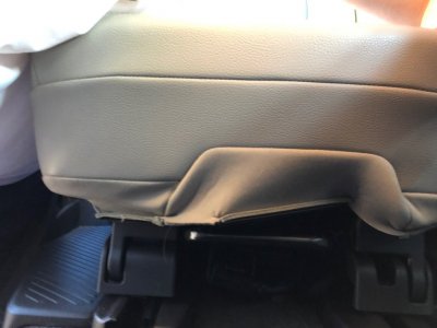

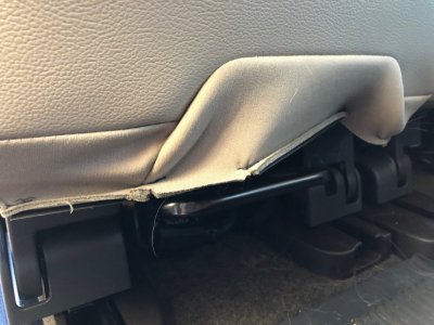

Anyone having this issue with the two outboard seats on a 2018 Limited? The middle seat seems normal. I took to Ford dealer to have it looked at...and when I picked it up there was no explanation and they hadn't fixed it. Even thought they supposedly inspected the middle seat for some safety issue recall. I was too mad to even confront them about it after seeing it not fixed. Thoughts? I can't seem to get the plastic clamps to hook onto anything...IMG_3094.jpgIMG_3093.jpg

I had a problem with my 2nd row passenger side captain chair. The leather came "untucked" from where the seat tilt lever is on top of the seat. I took it to my dealership where I purchased it. They ordered a whole new black plastic level and replaced it. Not sure that was necessary. They really only needed to take it apart and tuck the leather back under that part and reinstall.
But what do I know... Its repaired now.

Anyone having this issue with the two outboard seats on a 2018 Limited? The middle seat seems normal. I took to Ford dealer to have it looked at...and when I picked it up there was no explanation and they hadn't fixed it. Even thought they supposedly inspected the middle seat for some safety issue recall. I was too mad to even confront them about it after seeing it not fixed. Thoughts? I can't seem to get the plastic clamps to hook onto anything...View attachment 27849View attachment 27850
Not really a problem per se
Just tuck it back in. If it has a plastic bracket thingie sewn into the leather/fabric dangling loose, get under there with a flashlight/tumble it and find a thick metal rod OR metal edge that would be nearby if the fabric/leather were stretched taught, then pull it just past it and release for it to snap right on

The plastic "snap on" bracket sewn onto the fabric sometimes cracks and breaks. If that's the case usually it can be rigged with hog rings; though at times the entire cover needs replacement. It's the dealers' problem, but if you really want it fixed and you can't do it yourself, any upholstery shop should be able to tidy it up for lunch money.

Seats are fixed! By another dealership...but fixed none the less! I took it back to the first dealership and they had it for another 12 hours and failed to fix the seats...again. Said..."service tech unable to replicate..." INSANE!
