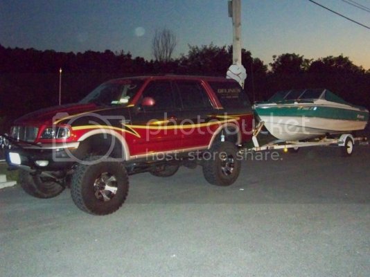

and towing a 17ft boat... yes mine have been amazing.... I believe KWT2000 also has them on his expy as well
