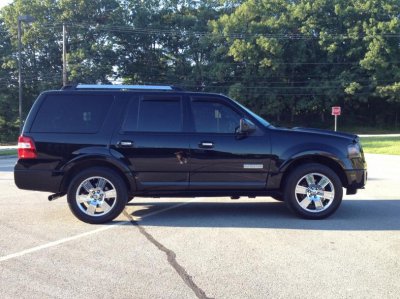

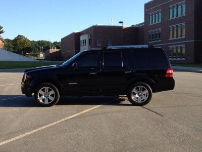

FWIW, I just went out and measured mine ( 08 Expy Limited 4x4 Regular Length- Non Air suspension)
Front ground to wheel arch 35 3/8" +/-
Rear ground to wheel arch 34 3/4" +/-
Seems yours might be nose diving quite a bit.
Attached pic of rake of mine.
Matt
