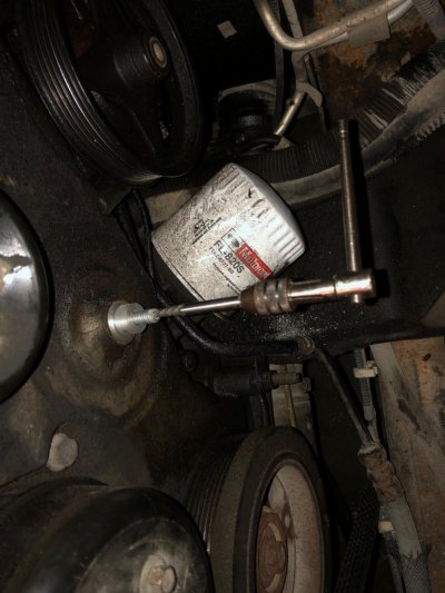

Well I had some fun this weekend, chasing a belt that squeals (only when the outside temp is 30 or below) I found the idler pulley just next to the power steering pump was a bit loose. I grabbed the socket wrench and found the bolt was not very tight. I tightened it up, gave it one more push with my short-handled 3/8" and suddenly felt it get loose (and the blood drain from my face)...

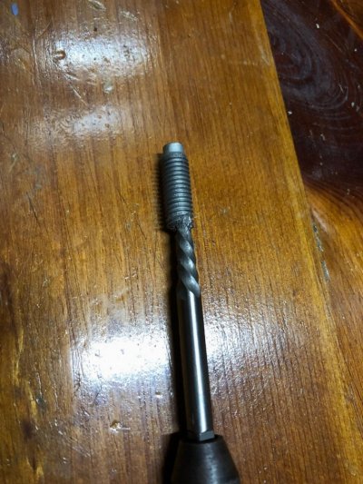

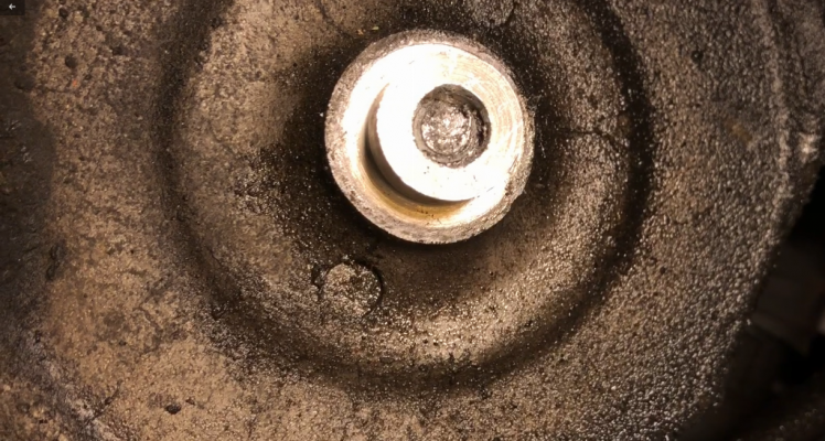

So I went and rented the fan clutch removal wrench, and got everything out of the way.. But the bolt broke at an angle and I couldn't drill the bolt without the bit wandering and trying to damage the threads... So i borrowed the wife's traverse to head to Harbor Freight to get a self aligning drill bit (marketed for door hinges)..
