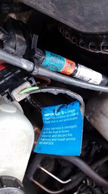

Cruise didn't work when I got my 99. Google explained about the recall and the secondary switch on the master cylinder. Fuse was blown so I replaced that and tried cruise and it blew again. Replaced and drove a while without trying cruise and fuse did not blow verifying it's the cruise circuit. Pic below is the harness on the master cylinder. I don't know if this is the original or the update. I have no qualms about bypassing the secondary switch to get the cruise working. I need the cruise as my bad knee doesn't like long trips if I have to keep my foot on the gas. What's the next step?

My 99 has that very same label/tags on the wiring harness but i couldn't tell you if it was ever replaced or what to even look for. sorry not really a help but figured i tell ya

That is the updated harness. If your fuse is blown, it means the brake pressure switch is leaking and shorting out internally and needs to be replaced.
