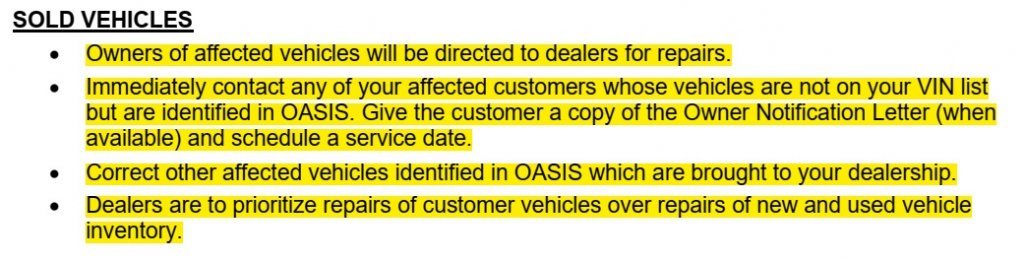

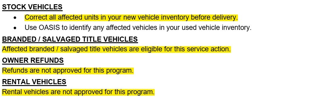

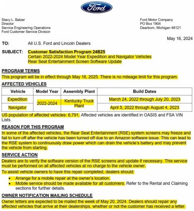

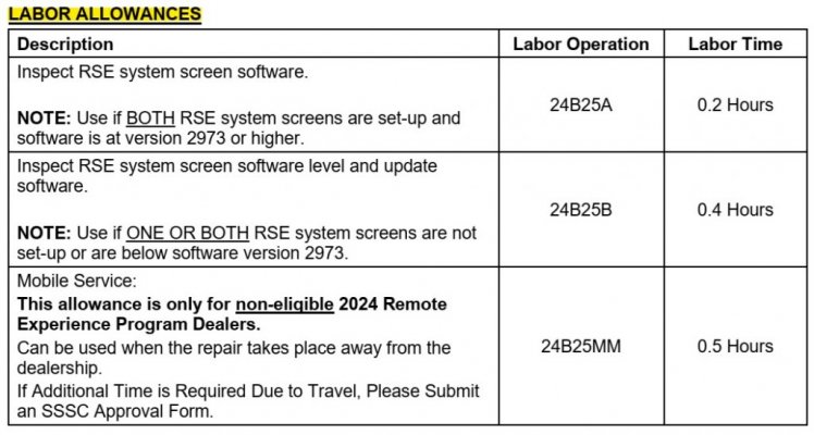

It's worth noting that Mobile Service to accomplish the inspection and any needed software update at owner's home or place of employment should be available to owners affected vehicles.
Additionally, the below-attached Technical Instructions document is straightforward and should equip interested owners to assess the software level on each Rear Seat Entertainment Screen.
  • Customer Satisfaction Program 24B25 - Technical Instructions.pdf

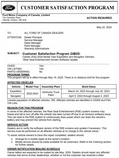

Ford of Canada is now also participating in Customer Satisfaction Program 24B25 toward 350 affected vehicles there...
