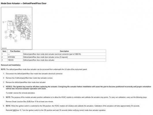

The lower blender door actuator for the defrost on the drivers side above the accelerator pedal is clicking. I can get the harness disconnected and the bolt next to it out. But there appears to be another bolt on the firewall side which I can not see nor remove.
It looks like I could access it by removing the the 3 large firewall bolts holding the accelerator pedal assembly to the firewall. I’m a little hesitant to just remove these since it’s drive by wire and don’t want to mess up the calibration.
Can I remove the 3 bolts and push it aside without a problem? Has anyone replaced this actuator and has some hints? Thanks
