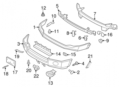

I think I saw one person attempt this. It's not a straightforward swap. They did a lot to revise the front end in 2015, including some of the sub-structure. You'd need almost a complete front clip off a donor truck (except for the front fenders).
2007-14:
2015-17:
2007-14:
2015-17:
if ir would push up to 3000k i am doing it man but i will not buy a damn thing unless am sure no welding will be made
