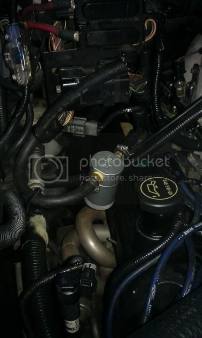

In this case, the original complaint was the truck was lacking power. Then we noticed the boost level on the gauge did not coincide with the specifications as noted by the manufacturer. Low boost level was one problem. A rich A/F ratio was a problem (9:1 A/F ratio, which is VERY rich). And it lacked power, obviously. So, we considered an improper tune and belt slip, assuming the blower was installed correctly. In directing John to look at specific problems, belt slip with a 3.0" pulley made sense, but the A/F ratio was still rich. Inspection revealed this...
The oil separator was connected to the 3/8" vacuum port at the rear of the intake and the other end was OPEN to atmosphere, and tucked away behind the intake. That eliminated the belt because slip issue (Most of it), because boost was being forced straight out through that port! The original PCV valve should be connected in the stock location. This separator should be routed from the driver side valve cover vent to the inlet of the blower to scavenge blow-by under boost, but AFTER the MAF in the blower inlet to ensure the air was metered only ONCE! The tuner tried and failed after at least 15 dyno runs, because a huge boost leak was driving the system rich, at a higher rate than the PCM could compensate for and probably outside the capability of the system!
When a member comes to me and purchases a new supercharger, (Even if fuel system upgrades have been purchased and are to be installed) when the system is tuned, we MUST verify the system is installed correctly. I always install the system as it comes out of the box, with the FMU and stock injectors and MAF FIRST. Then I fire it up and test drive it to verify everything is connected the way it should be and we don't have any problems, not even a belt alignment issue.
Once the installation is verified to be correct, THEN you can install the fuel system upgrades and go to the tuning step. Otherwise, if you do it all at once and run into problems, you know for sure the fuel system mods are not a factor. A process of elimination is next, and walking through the installation manual for potential problems is the place to start, then verify there are no connectors damaged or disconnected or make sure there are no boost / vacuum leaks. If you install the blower and fuel system upgrades, this creates many more factors to eliminate. It has proven to be well worth the additional time to verify the install first. Some might try to save by doing it all at once, and it may cause headaches and wasted time and money!
