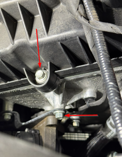

The kit's directions are pretty good as it's pretty straight forward (not in the kit, but downloaded Here). Only step that someone might need clarification on is the valve cover bolt removal. Once this bolt is loosened it needs to be pried out since it sits in a pressed spacer sleeve.

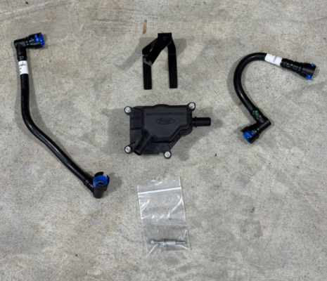

The kit:

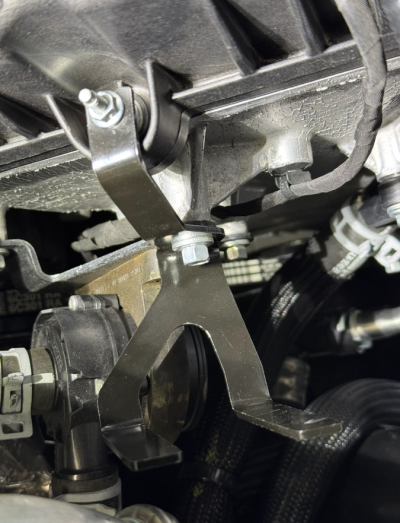

Vavle cover bolt removed and replace. Lower bracket bolt removed and reused.
Bracket in place:

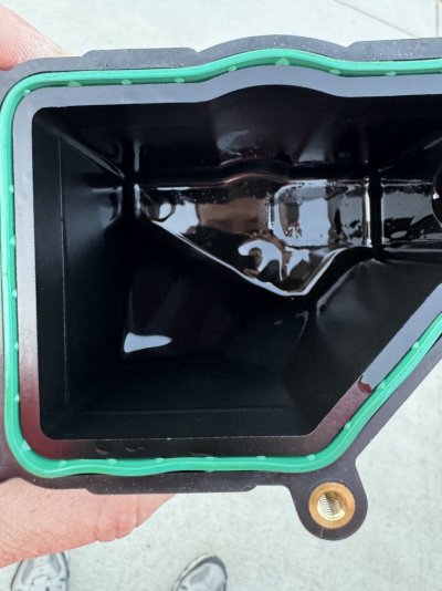

Just wanted to post a follow-up on how this was doing.
I did my spark plugs the other day and while I was hovering over the engine I decided to check out the can. Took about 10 seconds to undo the quick fittings and take out, so easy enough. After opening up the lid I found that there was a good amount of oil in it. More than I expected from some other things I’ve seen on EcoBoost engines (Bronco, F-150 write-ups, etc.). Guesstimating maybe about 2 or so ounces? I even spilled some on the ground out of the inlet tube being careless carrying it over to the work bench as I didn’t really expect anything to be there at all and didn't feel any sloshing. This was after 2700 miles on the nose.
Never had one of these before, but I'm definitely a believer now.
