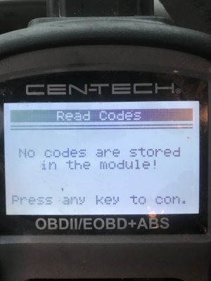

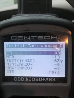

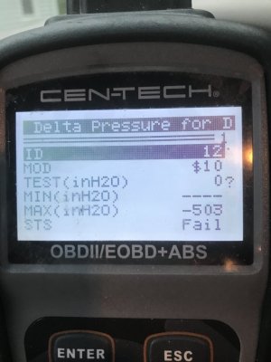

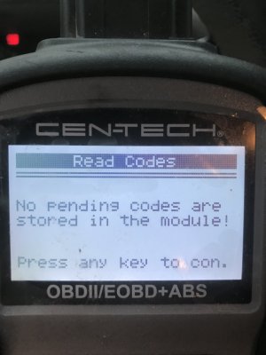

Here is what I'm looking at, are these numbers high and one reads zero? I have no DTCs but have not been able to get IM Readiness to pass for weeks on EVAP and CAT.
At Idle and acceleration to 60 - 65 mph both SHRTFTB1S1 and SHRTFTB2S1 show fluctuating readings, SHRTFTB1S2 shows zero continuously, and SHRTFTB2S2 stays fixed at 99.2. These were this prior to exhaust repairs.

Maybe I need a smoke machine? Any suggestions without the use of and air compressor? I see Amazon has a few AUTOOL unit for sale with built in air. I question the pressure on their SDT 106 unit. It has an output of 9-11 psi. I thought I read somewhere that an EVAP test should not exceed 1 psi. I questioned the seller and they replied with "9-11psi is the pressure range that the automobile pipeline can bear. If the pressure is too small, the leakage detection will not be carried out. I hope it will help you." Does this make sense?
