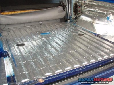

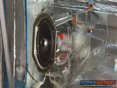

I used peel n seal, available a Lowes. search for peel and seal
Cheap, and you can add another layer if needed.
I did this to my Bronco a couple years ago, I still need to do the cab area. After a day or two, you won't smell the asphalt as some complain about. I did mine in the summer time, it has held up very well, no odor after 3 years. 18 bux for a 25 foot by 6" roll.It took me 3 rolls to do everything behind the front seats, beside the cap, left that alone.
Theres a few video's on youtube, search for peel and seal.
http://www.supermotors.net/getfile/741147/fullsize/p6090003.jpg
