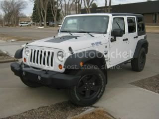

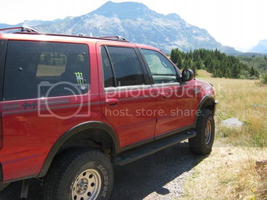

X10 on the plastidip not for the steps. I use it for trim and rims with no problems, but last week I stepped on my bumper with workboots on and scuffed a mark about 1 inch by 1 inch off of the top coat. Easy to touch up with a single spray, but it's not really gonna hold up to constant foot traffic.
I don't think you have to worry about the colors looking bad together. The plastidip is kind off a matte black. Not a true glossy dark black. It blends very well with my old faded steps... you can see in these pics,
and the rims and rockers on my Jeep. The plastidip is no more dark black then your tires are..
It looks as good with the old faded plastic of a 1998 vehicle as it does with the brand new plastic of my 2011.
