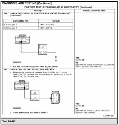

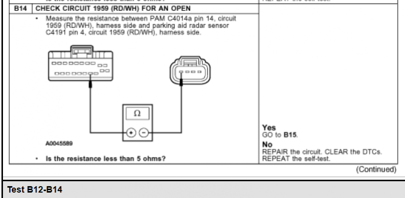

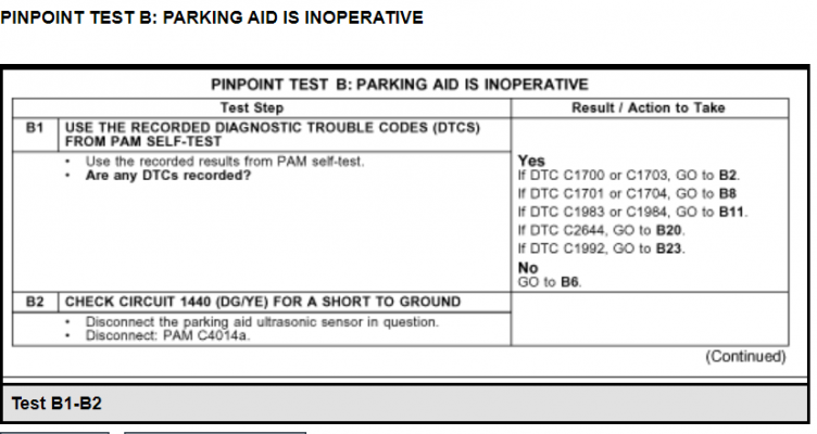

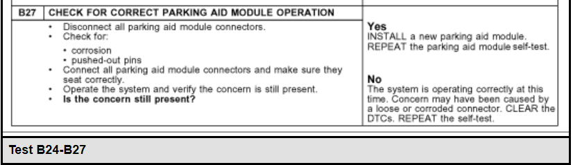

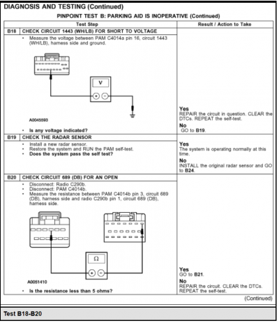

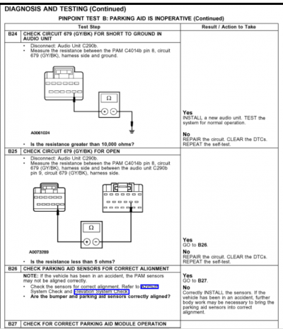

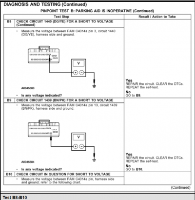

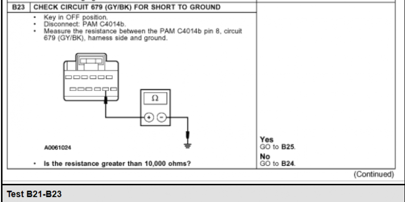

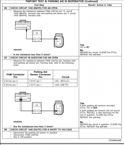

Could someone please clarify how to do a pinpoint Test B?
I could grab a used module but I'm thinking the module isn't the issue.
The harness was severed at all 5 wires during a collision with a rear bumper replaced at the dealer through an insurance claim.
The tech did the cheap fix and spliced the wires and used heat shrink. I pulled loom back and inspected for more wire damaged and found none.
The parking aid function was restored for a couple of weeks then stopped again. It's been like this for years and I want to fix it so I don't have to cancel out the reminder every time I run the engine.
When I run a PAM module test with forscan the speaker beeps once but short to ground persists.
I have a multimeter and test light but can't read diagrams for the life of me.
File attached is the diagram. I checked fuse 27, not blown
Any help appreciated. Thanks

Parking Aid Module Diagnostic Trouble Code (DTC) Index — Navigator, Early Build Expedition DTC Description Source Action
B1299 Power supply sensor circuit short to ground Parking Aid Module Go To Pinpoint Test B .
B1342 ECU is defective Parking Aid Module CLEAR the DTCs. REPEAT the Parking Aid Module self-test. If DTC B1342 is retrieved again, INSTALL a new Parking Aid Module; REFER to Parking Aid Module . CLEAR all DTCs. REPEAT the self-test.
B2844 Ignition Voltage Out of Range Parking Aid Module Go To Pinpoint Test A .
C1700 Left rear sensor circuit failure Parking Aid Module Go To Pinpoint Test B .
C1703 Right rear sensor circuit failure Parking Aid Module Go To Pinpoint Test B .
C1983 Radar sensor fault Parking Aid Module Go To Pinpoint Test B .
C1984 Radar sensor circuit failure Parking Aid Module Go To Pinpoint Test B .
