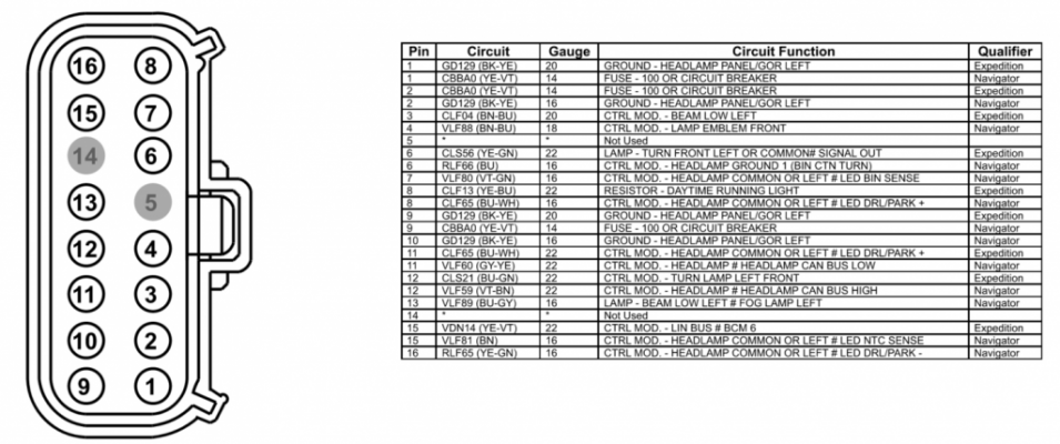

Has anyone installed Raptor style leds to their grille? What wires did you tap into for the 12V & ground?

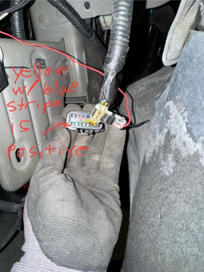

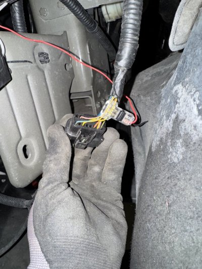

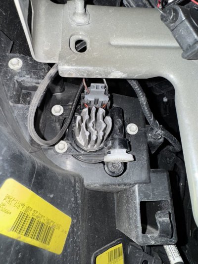

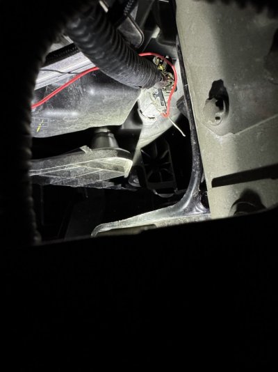

My Expedition is 2024. I hooked the positve to the Yellow with Blue Stripe. Looks like its Pin #8 on the diagram that you posted. I couldn't find a ground that would work so I tapped into the ground on the Fog Lights. The Raptor lights work with the parking lights. The plug is kind of hard to find. It doesn't have clip to hold it on, just have to pull it.
