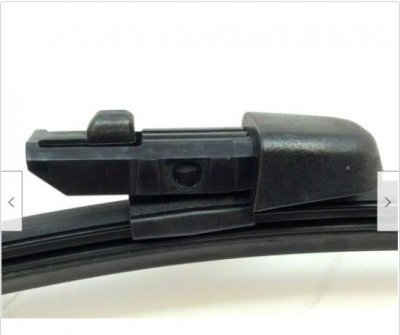

What you may be looking for is a ww-1614 blade. I found one that fit my 2016 Expedition XLT here: 2016 2017 Ford Expedition Lincoln Navigator 16" Rear Wiper Blade OEM WW-1614 | eBay.RearWiper.JPG
I found it for less money at Amazon Amazon.com: Motorcraft WW1614 Wiper Blade: Automotive
