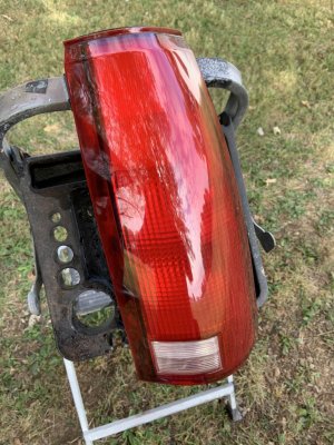

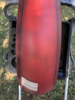

I’ve seen videos of people using brake fluid, brake cleaner, and paint thinner to remove the spray tint off of tail lights. I will not try this because I know those chemicals will dissolve plastic. I did the passenger tail yesterday. The tint was faded out and to me just looked like crap.

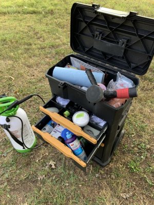

I used the 3M method of plastic lense restoration but with more hand sanding. This tint kept gumming up the expensive 3” Velcro disc so I switched to hand until I removed all the tint, then finished it out with 800 and then 3000 trizact pad and compound. Of course later I watched a YouTube of a guy using denatured alcohol and removed but with a lot of elbow grease.

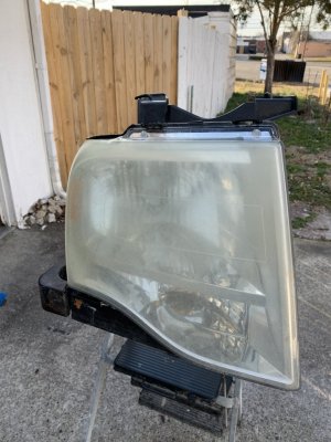

The tint made them look like an old cracked light with trash and mold settled in the bottom. I might get to the drivers side this afternoon. Headlights are really hazed and I might start on one of them. The battery life on the cordless 3” polisher really sucks, takes one and a half battery to finish one light. I thought of making a come to you business out of this, but not until I come up with a polisher that won’t die after one light. It’s 12V lithium 2Ah. I’d rather it be corded to a car battery I could recharge at home and do several cars a day.

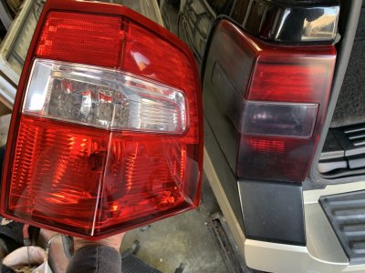

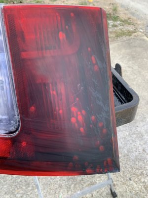

The left one was so thick it had runs thick as a penny. Against my better judgment I decided to go extreme and use the brake cleaner others say to do. Well, it dissolved the bond between the red and clear lenses. The clear one sunk into the light bucket. I had to laugh seeing it. I wasn’t mad because I noticed at the same moment the reason the previous owner sprayed the tint on so thick. Apparently he was hiding several cracks in the bottom half of the red lense. So I’ll be replacing the whole tail light anyway.

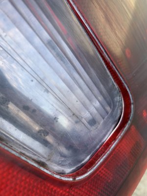

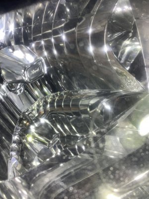

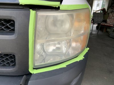

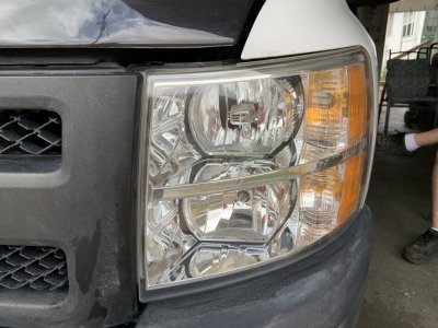

Before
After
It cleared but not happy with the end result.

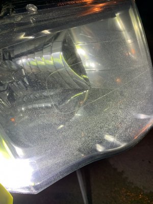

This is the worst stress cracking I’ve ever seen in a light. I wonder if someone had high watt bulbs in these. I stopped after trizact and didn’t bother with compounding.
