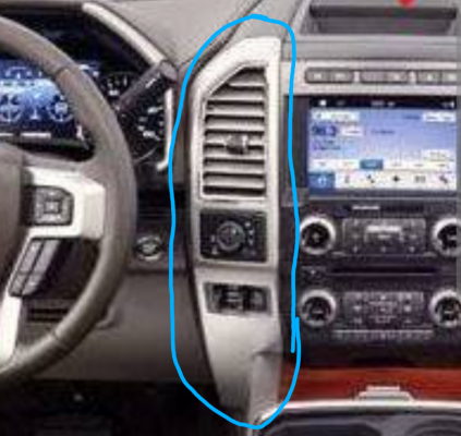

Can someone tell me how to remove this panel? I'm needing to mount a bracket. It's a 2019 expedition limited. TIA

I googled this once before a few weeks ago....
You need to remove the center panel first.....need to remove a few screws holding the top center hold all on top of dash to access the top screws holding the center panel. Once center panel is removed the screws holding the left and right panel are accessible.
Just google up "removing 2019 Ford Expedition dash panels" and a few how-too videos pop up.

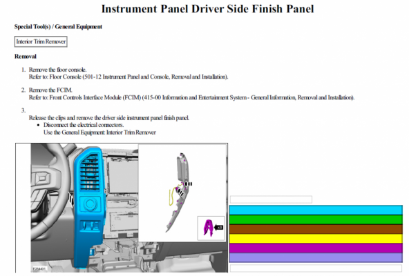

ProClip has a phone mount that goes in that location. They have installation instructions and a video on their website. It might help:
HILLY
May 12, 2023
320
236
Greenville, SC
In regards to that specific trim piece you are looking to remove, everything should unsnap. The floor console has to be removed to make clearance for the lower clips as well as the steps to remove radio/HVAC face plate.
