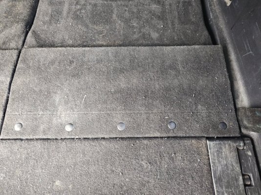

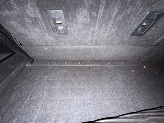

I am normally pretty good at the Ford parts web site, but am coming up empty here. I am looking for a replacement for this carpeted flap that covers the motor and mechanisms on the drivers side of the third row seats. Is this a part on its own, or part of a larger assembly? Part numbers and/or info would be appreciated.

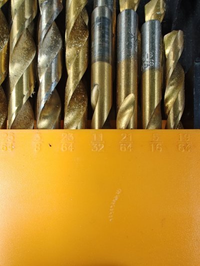

I used a small 3/16" drill bit to drill a pilot hole from the underside of each broken attachment point.
Then I used an 11/32" drill bit to drill through the panel from the "Top side"... This also cleaned out the remaining broken plastic stuck in the attachment rail...
If you are careful, it will all line up and is a relatively clean look when complete.
The 20mm/10mm Skirt Tree with 16mm head
11/32" drill bit

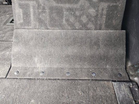

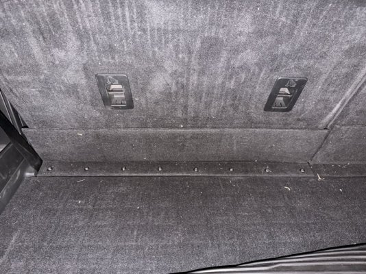

I just fixed mine in a 2020 expedition using zip tides. Let’s see how it goes.
