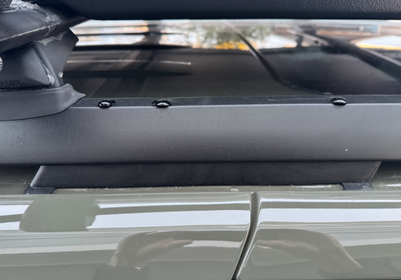

I tried everything and there was just no way to get something into the seem without taking everything apart and doing some modification to the parts. So, I just drilled some 1/4” holes, threaded them and screwed in some 1/4x2” SS bolts and walaaa, the noises are gone. We will see how long they work but at least now I know for sure what the issue is. I plan to get something custom made for the roof in the future anyway. Attached is a picture with the bolts in place.
