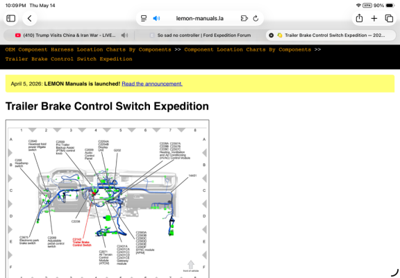

It looks like the connector for the factory brake controller is in the dash in position. I would look again.
