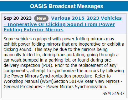

SSM 51265 Various 2015-2023 Vehicles - Inoperative Or Clicking Sound From Power Folding Exterior Mirrors
Released December 20, 2022
Some vehicles equipped with power folding mirrors may exhibit power folding mirrors that are inoperative or exhibit a clicking sound. This may be due to the mirrors being manually folded in, during transportation, going through a car wash, bumped in a parking lot, or found during pre-delivery inspection (PDI). Prior to the replacement of any components, attempt to synchronize the mirrors by following the Power Mirrors Synchronization procedure. Refer to Workshop Manual (WSM) Section 501-09 Rear View Mirrors - General Procedures - Power Mirrors Synchronization.
