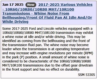

Special Service Message 53305 - 2017-2025 Various Vehicles - 10R60/10R80/10R80 MHT/10R100 Transmissions - Whine Noise From Bellhousing/Front Of Fluid Pan At Idle And/Or While Driving
Some 2017-2025 Ford and Lincoln vehicles equipped with a 10R60/10R80/10R80 MHT/10R100 transmission may exhibit a whine noise at idle and/or while driving. This may be identified as coming from the bellhousing and the front of the transmission fluid pan. The whine noise may become louder when the transmission is at operating temperature and may increase with engine revolutions per minute (RPM) in the park (P) position. A small amount of whine noise is considered to be characteristic of the 10R60/10R80/10R80 MHT/10R100 transmissions due to the offset gear drivetrain in the front support and has no effect on durability.
Announcement From Ford Professional Technician System (PTS)...
