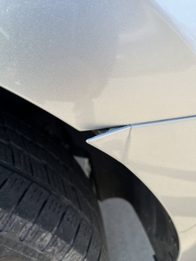

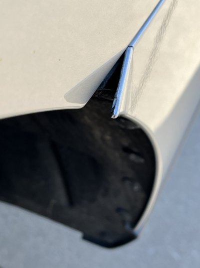

The other day at the car wash I noticed that one of the brushes pealed back the corner of my bumper. I'm hoping I can find something that I can glue or epoxy this closed so it doesn't stick out. I looking for sugesions on a good adhesive to use to keep this pieced closed so it doesn't get ripped off.
I already exhausted trying to get the car wash to pay for a repair and it didn't work and I don't want to make an insurance claim on something this small. IMG_2778.JPGIMG_2779.JPG

If your efforts fail at the car wash, you might try a PDR guy. They can heat the plastic up enough to reform it without melting the paint. Once it's close they can tack it back in with epoxy or double-stick tape. Won't be perfect, but it'll look better than it does now.

Used boiling water to soften the plastic nothing hotter we know the boiling water is 212°. That's enough to get the plastic soft but not enough to do any damage to anything else you will need two epoxy it in place a good six to eight inches back towards the rear of the car. You will need a clamp and a small block of wood in order to keep it pressed in place while the epoxy cures and maybe a few hours after be sure to do it on a day that is warm enough and that everything is very clean I have this exact problem on my 20/20 Expedition Max and as soon as I get a warm day that is my plan to fix it I consulted a body shop that I use regularly and that is what they recommended replacing the bumper would be $2,000 it wraps all the way around and would need to be painted

if You will not get nothing from washing company and You do not want to spend to much money
1 - home made
if You heat the plastic it will become flexible
then make the right shape and tape it from upside that it will not got out
from inside You can use some temperature glue (from gun)
leave it for 2 H and it should be ok
2 - go to some detailing company - they will fix it
