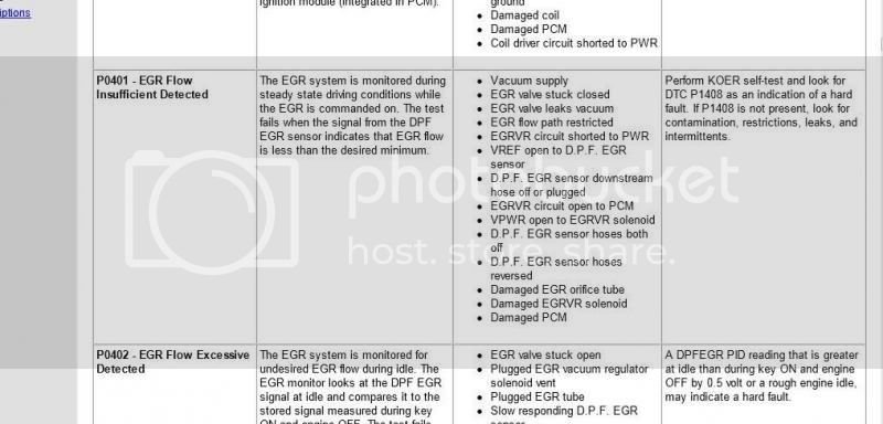

While driving home from work yesterday I happen to look down at my radio and saw my OD light flashing. I was doing about 65-70 and did not notice and shift problems until i got off the exit and noticed a very slight bump when it was going into 2nd and then third gear. I pulled over shut it off then back on and no more light or bump i drove around for another hour and it never happened again. then again this morning at the same speed it did it again so i again cut it off and started it back up and it went away i have been driving all day with no issues. where are the codes stored from the tranny? i went to auto zone and got the cel scanned and got a code p0401 and something about bank one oxygen sensor. any ideas?????

I had this similar problem and It is probably not your trans. I took mine to the trans shop first and he was a good fellow and told me I didn't have a problem. He had it hooked up to the big mobile scanner. Being that you have code 401 I'm guessing your cat converters are clogged. Mine were clogged up with what looked like concrete. They were so bad I had them leave the rear ones off and run straight pipe. The truck instantly ran GREAT and still does to this day!!! I also replaced all 4 O2 sensors. Just throwing that out there. Good luck with yout truck.
