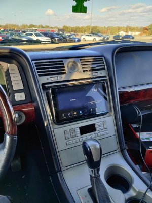

Pioneer DMH-WT7600NEX head unit

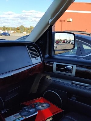

Kicker 47KSS6804 6x8 Components in the front
Kicker 47KSC6804 6x8 coaxial for rear doors

When its done it will have wireless android auto and carplay, USB C connectivity, HDMI, Miracast, and the rest of your typical radio options. 9 inch HD display w a capacitive touch screen and the floating tablet look modern vehicles have. Mock up looked great despite the truck being an '03. The amp offers a really nice DSP with autotune, 40 band eq, time alignment, etc. This should greatly help the soundstage with minimal cosmetic modification, only the tweeters have to find a home.

I have to say I'm fairly impressed by the Kicker component 6x8s It really changed the soundstage up front with minimal effort. The key amp before tuning was loud and clear but was lacking. They did a fairly good job w dsp in that one, especially at the cost. It, like my powerpack in the expy has been mounted inside the dash cavity so no clutter in the cabin and easy wiring.
All in all, my wife is quite happy with the upgrade, especially that giant screen in the dash. It really updated the look and feel of everything. The interface is smooth and reasonably well laid out. It has so many options that it is inherently complex though and has a bit of a learning curve to know which way to swipe to get where you need. Android auto loads very quickly on wireless or USB connection. The 3A charge from the type C connection is a welcome addition. My 4500 in the expy is still has two type A ports and is limited to 1.5A.
The lighting options are handy, it has a few presets available as well as a choose your own color along w brightness/hue. The rear bias lighting behind the display is a nice touch and gives you a sense of some personalization similar to what sync offers. The display itself is highly adjustable. It has a control panel similar to a TV and you can adjust brightness, dimmer settings, hue, contrast, color temperature, etc and is very bright. Daytime use is no problem with direct sun on it.
