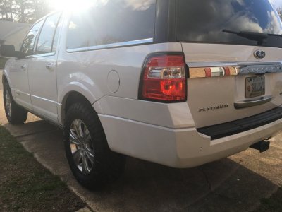

Vinyl wrap tail light edges
B-McD
Jul 12, 2016
240
111
Illinois
White or silver are the only colors that would look good against. DIY?

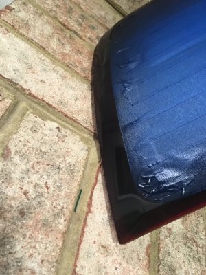

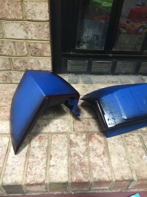

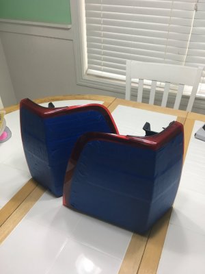

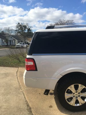

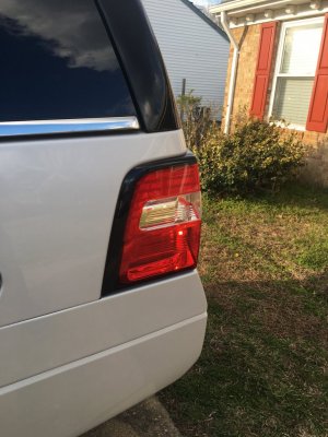

Yeah, I’m going to be painting the edges for final product bc I had to use 8 different cut outs of vinyl to get tht look. Too time consuming and paint will last longer
J Ski
J Ski
3.5plati
Apr 4, 2017
1,021
484
VA

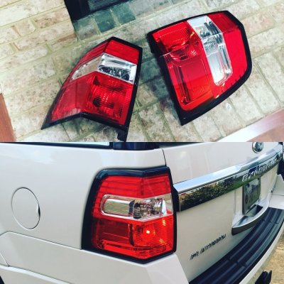

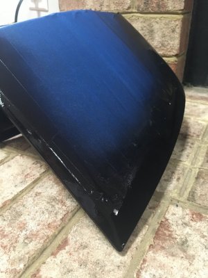

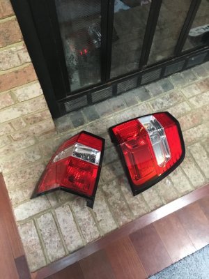

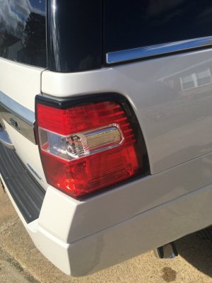

Went with rustoleum lens tint. Tape off, scuff with green scotch bright pad, 3 coats with 10-15 minutes between drying. Here is each coat and then finished product. Still drying so not back on truck yet AAE0AEE5-C2F1-4302-91F3-C8C82CC4E3C8.jpeg9C950C7F-87FC-457A-BC84-FADC33407EFC.jpeg74118409-77A5-4256-90E5-041B7BCDC293.jpegF05E0029-57F6-4E6F-A216-786E7862E166.jpeg5BF2B56D-44E7-4C98-ABA6-CB59DB1012AD.jpeg

Definitely makes the lights look a little more high-end. May have to do this to the wife's Magnetic EL.
