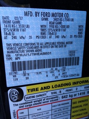

I'm having a heck of a time figuring out my true payload capacity of my 2010 EB 2x2. Google and you get numbers that have quite the range. I've seen 1,822 to 1,895 to
1670 lbs. Any idea?
Trying to figure out if I can take my big self and 3 or 4 nephews safely while towing for a camping trip, lol.
6,530
3,140
Yellow and red sticker below your vin sticker. It will say max weight of cargo and occupants on top of the sticker

Duh, yeah I guess I should have checked that. Very surprising, only 1402#. It's very concerning when you do the math with trailer tongue weight, cargo, and passengers how often you at or over the limit.

That is interesting. My 2007 EL Eddie Bauer 4WD has a payload of 1,580. My old XLT was 1,760....I assumed the reduction was going to the EL.

Curious if you this number on the sticker is assuming a full tank of gas or do you have to factor in your gas weight in the cargo?
bobmbx
Jun 11, 2017
1,200
627
Virginia
A full fuel tank is included in the "Curb weight", and is not considered cargo.
