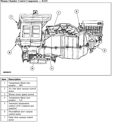

I have auto controlled dual climate zone and i have replaced every mode/blend door actuator except for the drivers side blend door actuator and i am having trouble finding it.
I have already found the passenger side.

I will look but I recall the driver’s side is on the bottom and the passenger side is on top.

There's some info in this thread regarding the driver side blend door. I replaced it twice recently since the first failed after 5 days. Both were new Motorcraft repalcements.

Read whrbronco’s thread, excellent writeup with pictures! This will get you the step by step to replacing the lower actuator. It all needs to be done before removing the dash anyway! I have had several Superduty trucks apart to do the same job. They are just as complicated. Most people don’t keep vehicles as long as we do. I have had a gen 2 Navigator since 07. They are very reliable but and survive high speed accidents well. That is why I own two and have an adult daughter in a third.
