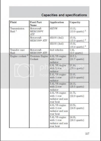

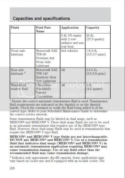

Two pages out of my 2000 Ford Expedition owners manual:
It seems to contradict was has been stated as far as which transmissions use straight mercon vs mercon V.
I believe I read somewhere ford issued a service bulletin on the subject, as far as use of mercon V in earlier expys rated for straight mercon, but don't know where or what it is. Hopefully someone can post if they are aware of it.
The owners manual does make it somewhat clear that the fluids "dual rated" are not recommended for vehicles in which straight mercon was specified.
My dipstick does indicate Mercon, not Mercon V by the way. (4r100)
