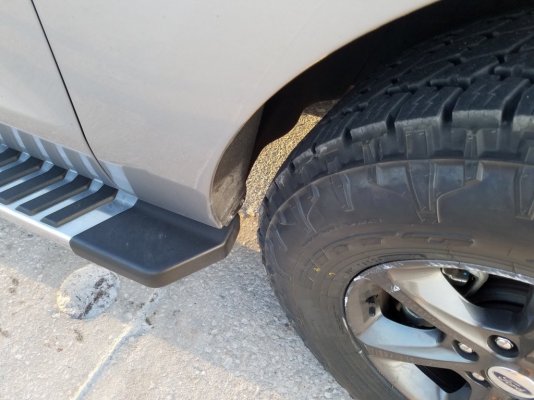

**I hate that the rear tire has moved so close to the rear step/fender. The only good news is under compression, it swings back giving it more clearance. I may look for some trick to make it look better**

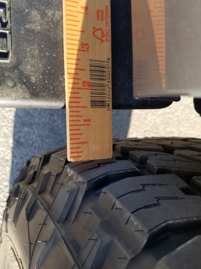

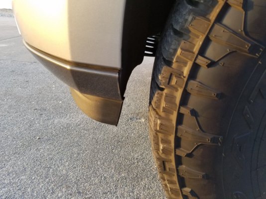

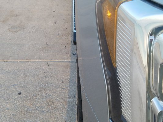

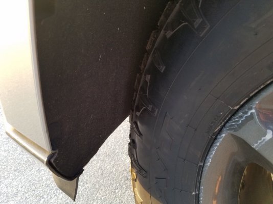

And as predicted the front rub when turning. They rub the front wheel well (but with 2.5-3 inches of lift and they would just clear) and I had to remove my front splash guards or they would rub there too (will cut and replace). **A true 33-33.2-inch tire should clear here though, but not a 33.6-inch tire IMHO. It is that close. I will be cutting and rearranging, and even if you run the Expy shock lift at 1.6 inch of lift with certain 33-inch tires much above 11.5 inches—you might be cutting and rearranging too. Before you comment, please feel free to measure your own tires (as the companies rarely provide exact measurements) and remember no two vehicles are exactly the same and if you are running wheels with more offset that could solve/cause issues too. Still, you may clear by 3 mm—or not notice the rubbing. Mine is mild enough in some circumstances that I can’t tell/feel. YCMV lol.

IT is VERY tight in there both front and rear with factory rims and .25-inch spacer (you guys with rims that poke out more can help—but not as much as you might think. You might clear in one spot and rub in another.

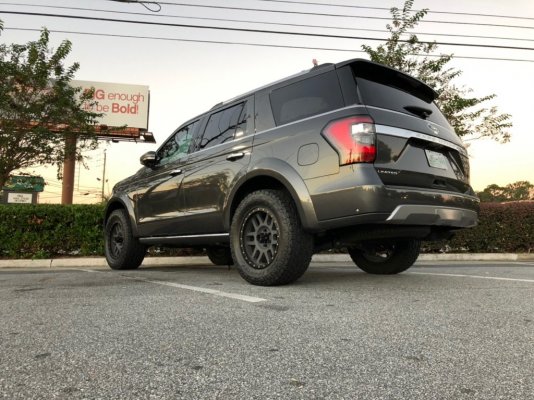

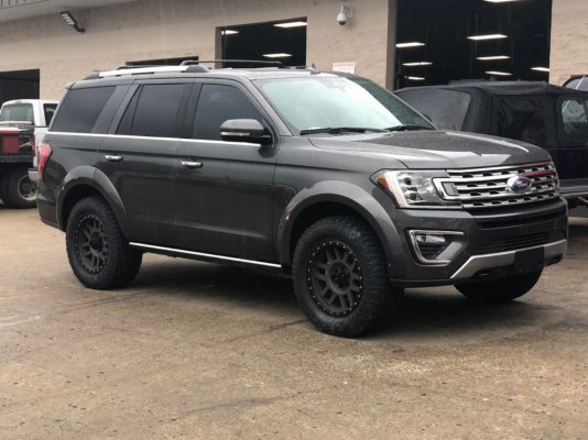

Strangely enough, the front dropped to 39.0 so this is a full inch off from what other members have experienced (95Scobby in his 2018 FX4, and another member with a blueish 2wd). The rear stayed at 39.25. FWIW, this is the exact dimensional lift I had prior (36.0 F +3 / 36.25 R +3). If I keep this rake, it will work as I tow or load up.

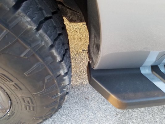

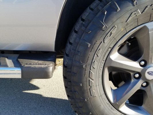

![full?d=1616332172.jpg full?d=1616332172.jpg](https://www.expeditionforum.com/data/attachments/66/66340-181fa35b3c22d0b9606256ec7ec5ca91.jpg)
I am at a loss as to why. It is clearly lower in the front even from other’s pics here on the Forum. But I am operating from the lowest C-clip on the shock body, so I have nowhere to go but “up.” I am considering raising it one spot up, and this may be useful in the future too if I add a winch/bull bar as I can adjust shock to spring squish from the added weight (not ideal, but better than losing all the lift due to added weight).

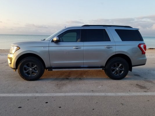

Without going in to too many details, the only “D” rated tire (like factory) I could find that I felt gave the look/size/lift I wanted where rubbing would be minimal and weight 10.6 pounds heavier from factory (40 vs 50.6) were the Nitto Terra Grappler G2s in 295/70-R18 116S.
According to Nitto, they are 34.29 inches tall and 11.7 inches wide, for a total 2.2 inches taller and .7 inches wider than the factory Michelin Primacys. Actual measurements of the tire while mounted and aired on the factory 18x8.5-inch rims, they measured 33.6 tall and 11.7 wide.
My Primacys (with 20k on them—but a lot of tread left), when mounted on the truck and measured from the ground, were 31 inches tall (1 inch of ‘squish’ from truck weight on tire). The Nittos as mounted and measured on the truck are 33 inches tall (front) so .6 of squish.
Realizing Nitto’s lack of accuracy, actual lift of frame/suspension parts is 1-inch from ground when stopped (old squished tire vs. new squished tire). But If Nitto HAD been accurate in their tires measurement, my truck would be rubbing everywhere way worse as well. Still, I paid for 34's and would hesitate to say "I am rollin on 34s dawg..." when they are really 33.6s...

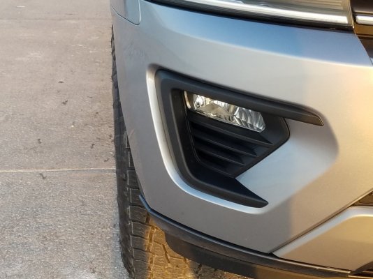

Front:
![full?d=1616332220.jpg full?d=1616332220.jpg](https://www.expeditionforum.com/data/attachments/66/66345-a289dcd2567a2a9f31b8fc60e4eeafaf.jpg)
![full?d=1616332220.jpg full?d=1616332220.jpg](https://www.expeditionforum.com/data/attachments/66/66346-27bcf2a3cb6fa893086dd01a355f6583.jpg)
![full?d=1616332172.jpg full?d=1616332172.jpg](https://www.expeditionforum.com/data/attachments/66/66347-6edff637443be21c42e21a52376b3f0e.jpg)
