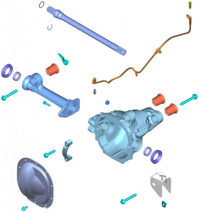

What I am seeing (you can see in the video linked below) is play in the front passenger side axle where it meets the differential tube or stub (not sure what it is called). Picture included for showing the tube I am trying to describe and the bearing in question. This play is up and down and front to back (0 play in and out). I would guess this would be enough to cause a high speed vibration but I have seen in some fwd cars where this play is normal at the transmission. I looked at the ford parts site and I do see that there is a bearing right at this location so I would suspect that there should be little to no play in this area but I also note that the axle will spline with the shaft at this point also so that may be the play point.
