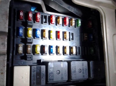

i took a couple different photos of the fuse boxes. know which one i should test?

Check for water leaks around the windshield. Sounds like a GEM issue. How many miles are on your truck and has the windshield ever been replaced?
You also might want to run two wires from the battery to the leads on the window motor in the door. Put the leads on one way and the window will roll up or down, switch them and the motor will reverse direction. This will confirm that you did not just coincidentally have this stuff all go bad at once, which I doubt it did.

136k miles. I changed the windshield a couple months ago, nice and sunny here in California, both right windows worked fine when I bought it, I did install aftermarket amp and kickers., did the wiring myself. After that I think the right windows stopped working, I might have shorted something, Weird how both right windows stopped.

LOL. I fixed all my power window issues now. It was so simple, my wife drove the expy and accidently pressed the window lock button. I ended up switching it back and forth a dozen times and tried the windows, they all work again. I'm guessing the wimdow lock switch is corroded. But all power windows work now. Phantom mechanic helped me out,
