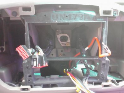

Thermo today i took the radio and the climate control out and could not find any relays could it be some where else? and thanks for the help.

Charly, I don't have my normal resources available to me any more (Win7 bit me good). But, the relays are supposed to be to the left of the radio, right in that general area as I recall. If you look around in that area, it is going to be the only 3 relays that are side by side.

According to the wiring book, the "lock relay block" is located behind right side of I/P. The picture makes it look like it is all the way on the right side.

There are relays under the dash cover(the big oval part on the right side but I don't know what they control)

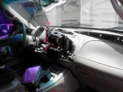

C
Charly
Feb 18, 2012
53
Miami
Well after working in the Florida heat looking for relays, took apart the whole dash and found nothing. going to stop by a junkyard soon to find a RAP module and test that there on the spot.
