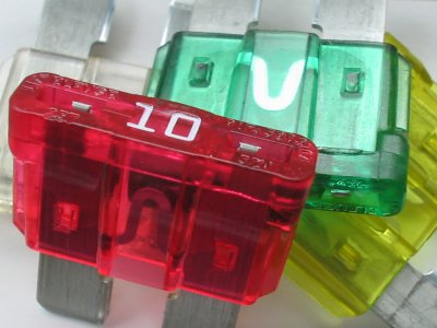

Look at the attached pic See the metal tabs on each side of the "10" You can test those tabs for voltage One lead to the tab and one lead to ground Test each side and you should get 12 Volts No need to pull the fuse
