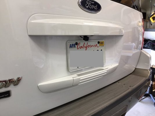

Here is how I mounted my backup camera. I routed the wiring up through the existing boot at the top of the lift gate, through the headliner, down the drivers side A-pillar, through dash to the stereo location. The routing of the wire is not technically difficult, but it is a little tedious. It will be helpful to remove interior pieces as needed for access. They come off pretty easily and logically. Take your time and invest in good interior removal tools.
I installed a Kenwood head unit. Sounds great and functions well. It’s beautiful at night but has a lot glare during the day. Also, polarized sunglasses make it almost unseeable.
4EF4C478-C239-4828-B918-34462AB400DA.jpegF447AB93-8794-48A2-993C-4B2889C54BFA.jpegCB0F6456-B916-4B17-BF29-8E0553B8056D.jpeg0EE479DA-17C3-4669-9106-96EF5BD8E72D.jpeg.

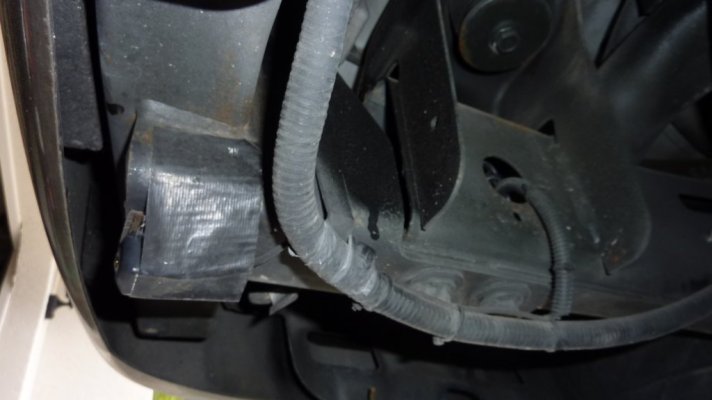

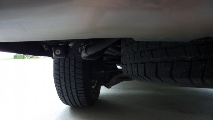

I just mounted mine to the frame tube on the driver's side and ran the cable up inside the frame tube, up to the emergency brake cable grommet and along the brake cable to the interior. Up and over the steering column to the head unit. Pretty simple and quick. Gives a great view when backing up, and shows the trailer hitch when I'm trying to connect my boat trailer. It's a Pioneer and came with the head unit package.
The tape is on there just to offer some protection to the camera from splashes from the rear tire. Not really needed though. The camera mount is bolted to the frame with SS 14 x 20 pan head screws.
