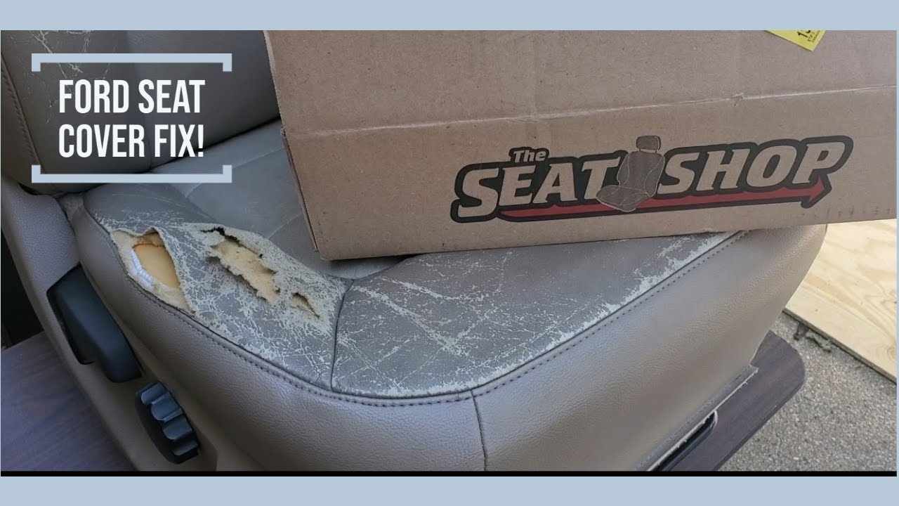

This video may help you with the lower seat cover replacement. I installed the driver seat lower foam from TheSeatShop and it's been wonderful so something to consider if you're foam is not in great shape. The wire grid had cut finally into the original foam and was not comfortable. The replacement foam is is reinforced on the bottom to help prevent the same scenario.
