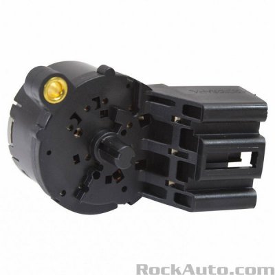

Update: replaced the ignition switch, truck still has issue. Will be taking it to a proper mechanic tomorrow to get it diagnosed, cannot keep throwing parts at it.
