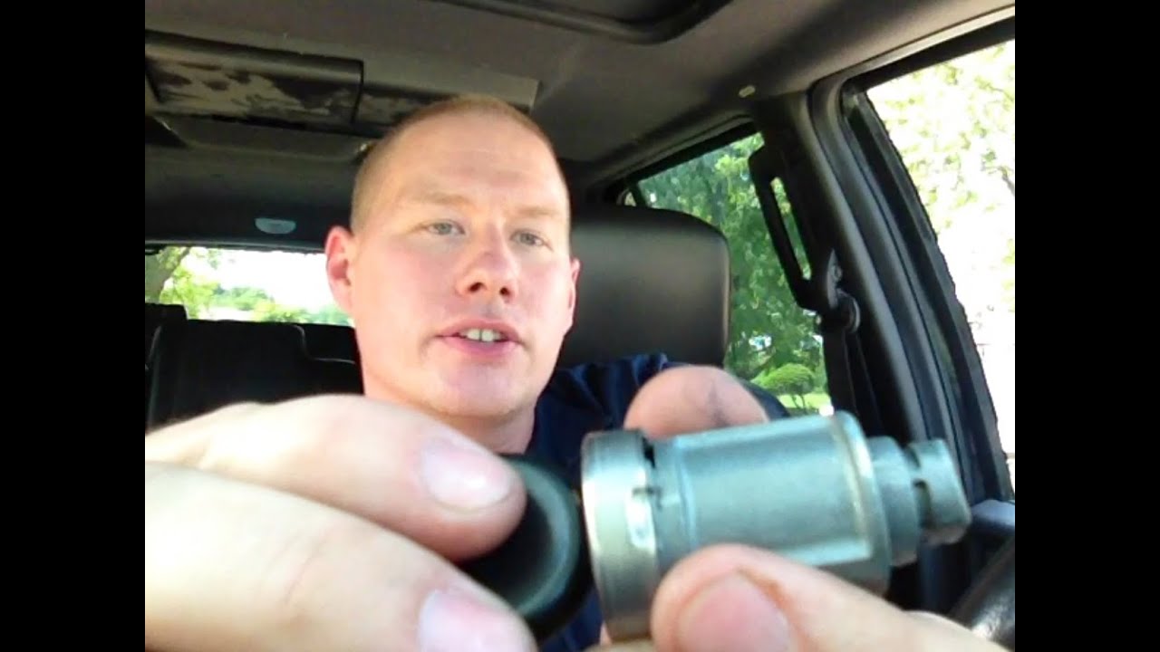

I'm going to replace the ignition starter. This video seems like exactly what is happening to me and the Expy is a 2010 just like mine...
