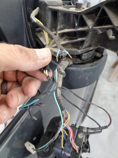

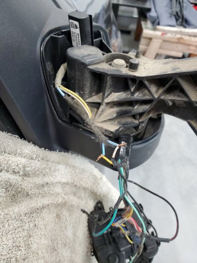

I removed the glass via dcsang's instructions, which were invaluable. Uscrewed the tilt motor and removed the blinker light. Removed the entire plastic housing exposing the plastic arm and wiring. I immediately noticed a broken wire on the two pin connector shown below. I also could see that the mirror would still lock into it's detent, just that the detent was in the wrong/semi folded position. Searching for info on these two wires and the little "Magna" module they connect to led me to believe they had something to do with the fold motor circuit. I tried to salvage the two pin connector to reconnect the broken wire but ended up ruining it in the process. So cut the connector off and twisted the wires together to test. Folding the mirror in and out a couple times resulted in the detent stopping in the correct position. Soldered the wires together and tested again with perfect results.
I do believe sometime during the several weeks that the mirror would not stay in the correct position it went from folding correctly to not folding at all. May have even been intermittent folding/not folding. I assume that was due to an intermittent connection with this broken wire. Either way, it appears to be fixed and I will road test it as soon as I get the front brakes reassembled!
