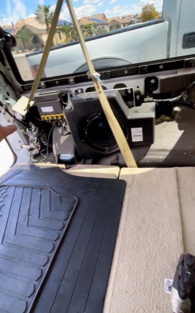

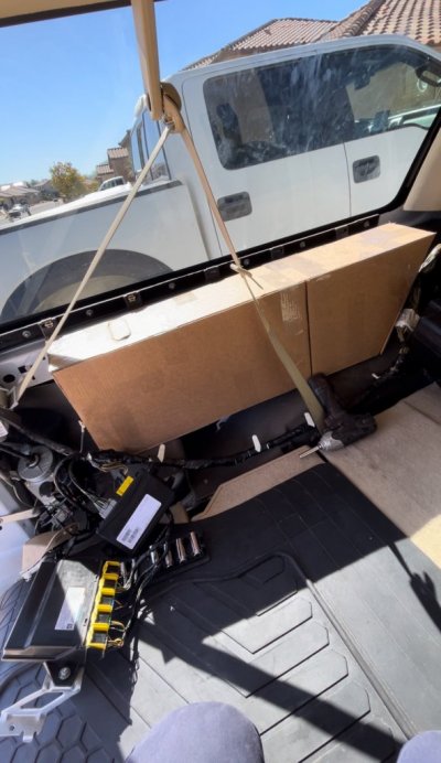

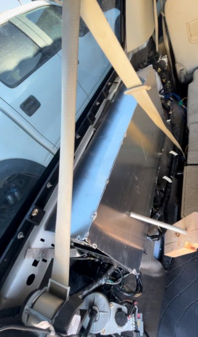

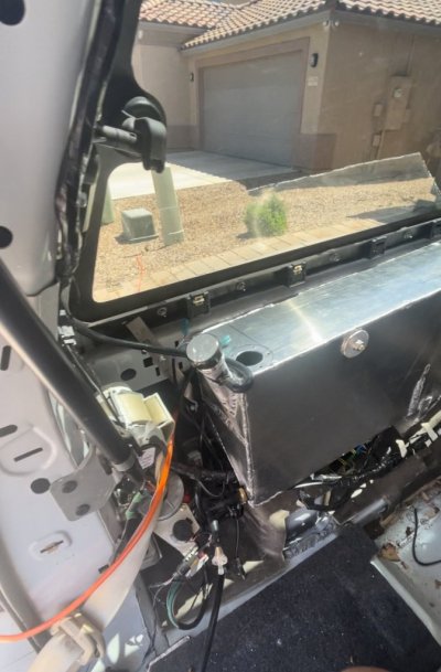

Hello all- got around to making a hidden tank that sits in the drivers side wheel well space. We go alot to the beach so this will workout well for rinsing off.

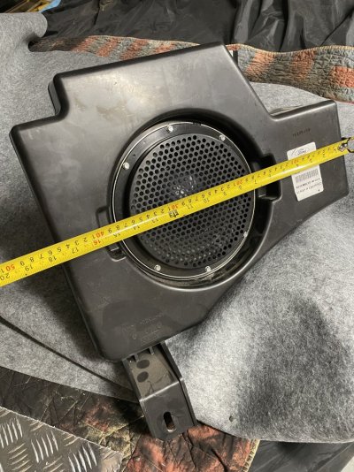

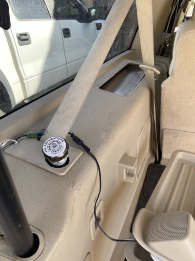

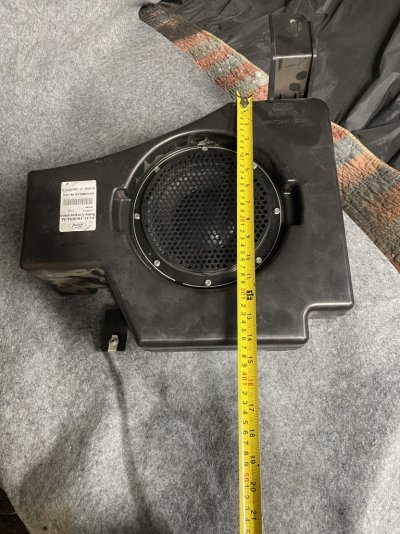

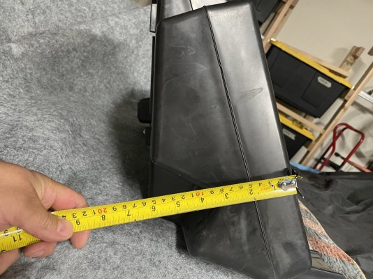

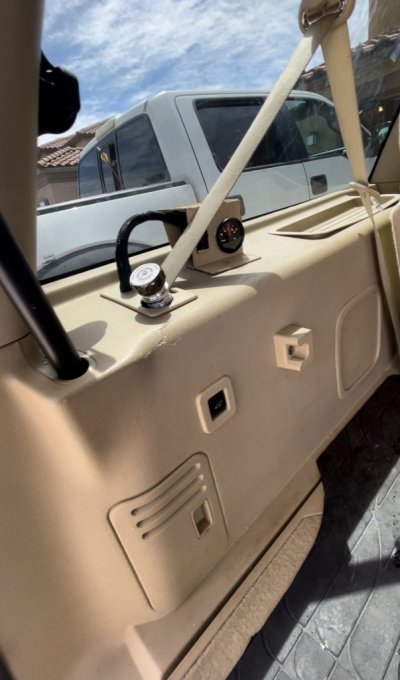

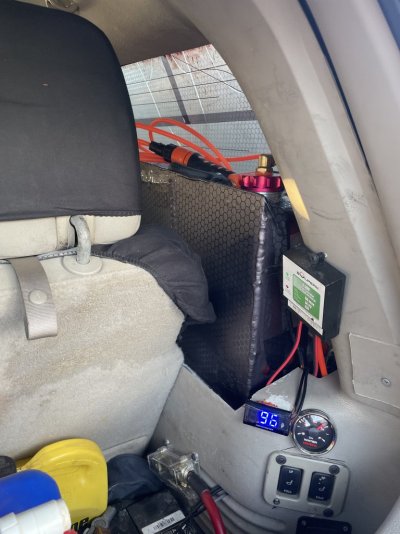

I know- You loose the subwoofer, well as of now, the wife dont care and it does not bother me. I can make a box for it later if wanted. Its a 7 gallon tank. I 3d scanned the area before making a cardboard template that turned into this aluminum tank. This gravity feeds the pump on a simple key on circuit and has a water level gauge.

Thanks- looking forward to hitting the beach. This is the first hidden tank I have made so pretty stocked it came out like that. Im gonna make a new level gauge cover out of aluminum once I have some leftover from a job. Gonna sit lower and more streamlined

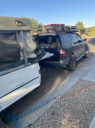

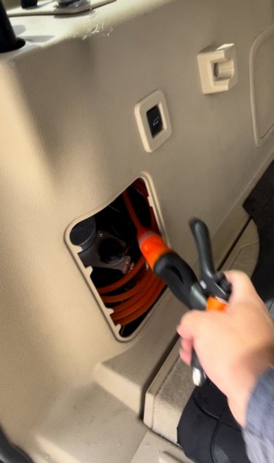

Got a chance to use this tank this weekend- took the kids to the family ranch for some good old fashion horse back riding.
Used the spray nozzle to wash off hands, bbq utensils and even did some moderate off-roading as the road in was all washed out. All good
