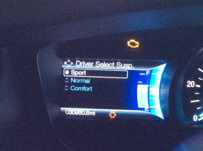

Thanks in advance for the advice. Bought my wife a 2017 Expedition EL with the XLT trim about a year ago. It was a year old, had been an Enterprise fleet vehicle so it had a lot of miles, (therefore I was able to get a really good deal). The drive and ride was great, handled better than any expedition we had before (we had 4 over the last 10 years). Problem was, since it was an XLT it didnt have many of the things she wanted and was used to having with the others (leather seats, heated seats, sunroof, remote start, etc.). So for Christmas I went to the dealership, found a 2017 EL Limited that was the same color and had almost the exact same mileage as the XLT she already had, the Limited was in beautiful shape and had new michelins on it, but most important had all of the bells and whistles she wanted. Now I'm hoping I can get some good information from the years of experience and knowledge this forum has.
PROBLEM: After driving the XLT she had for almost a year, then going into the Limited we got a big surprise, the ride wasn't as good and there is a rebound anytime you are driving at speed and hit a bump.We were driving last night 55 MPH on the highway, hit a bump on the right side( looked like maybe a buckle in the asphalt) and the rebound was so bad it almost moved me into the other lane. I know this isn't normal. Just wondering if this could be a bad strut or maybe something else. I know that this Limited should ride and drive at least as good as the XLT if everything was right. I appreciate the help.
Could be alignment issue regarding it jumping all over the road when you hit a bump. I wouldn't expect 20" to be as comfortable ride as 18".

OP: I would be taking a solid look at struts...that kind of response to the road doesn't sound normal.
