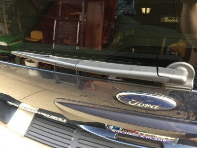

I’m trying to replace the rear wiper blade, but can’t find a correct fit from any of the 3 major parts stores (O’reilly, Advance, Autozone.). Appears the 17 rear wiper is different than earlier Expys. Has anyone found a supplier other than Ford Parts for this?

Pretty sure you have to buy the whole wiper not just the blade for our newer trucks

Same for my 16. I have had to source it from the dealer but I see it out on the web now. Part number WW1614 is what you need. The pic from O'Reilly's site should match. All the other ones have a plastic body which is not compatible. Dealer charges about $19.
https://www.oreillyauto.com/detail/.../wiper-blade-12822/wiper-blade/ww1614/4493754
Keep a spare one handy - I have had those small black buttons on the end fall off and then you have the rubber inserts flapping around. Good luck!

mreed112 - that is the OTHER style for the expedition. That's what I first got at the dealer. Even he had to order the other style. Depends on the year of the truck.

I think starting in 2011 you have to order it

The TRICO 16J fit my 15 KR perfectly and as far as I can tell is what Ford used as OEM at the plant. They may have changed to the beam style blade at some point.

I tried the 16J thinking it probably didn’t change from ‘15 to ‘17...but looks like the rear wiper changed from ‘16 on to the WW1614.

I have a 2016 and the Trico does not work.
Is it possible to put the arm from a 15 on the 16 so the Trico will work?
As mentioned above the end caps fall off the newer beam style rendering the wiper useless.

Black - I put a dab of clear silicone adhesive where the cap meets the arm. Multiple automatic car washes this winter and still holding.
