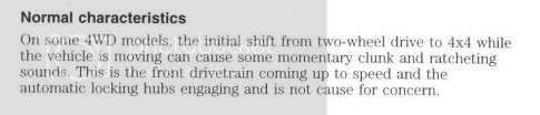

Ford doesn't recommend running in 4WD on asphalt , it is right in my manual , and Jeff ( a ford mechanic of 22 years ) a friend of mine told me the same thing , you can do it on a roll 10 mph and under , ( normal , it will clunk a little bit )
its your truck , you can do what you want .

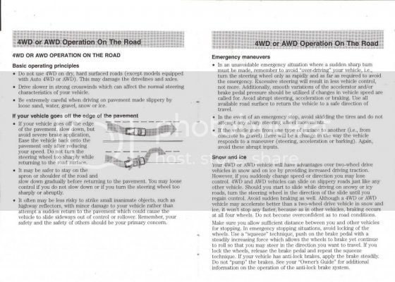

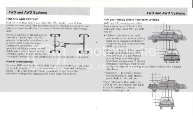

I could be wrong , wouldn't be the first time ? It states Do not use 4WD on dry , hard surfaced roads except models equipped with Auto 4Wd or AWD This may damage drive lines and axles ? It also states that in normal AWD mode ? It is like 2WD , and as traction is lost at the rear wheels , it will automatically transfer torque to the front wheels up to 100% ? are they talking about normal operation ? which is limited slip as compared to 50/50 in 4x4 ?
It is my understanding that Auto AWD is the running mode on the street ?
