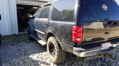

The day after I took her up to my shop, there was a swap meet in town, where I scored some 285/75/r16 (32.8x11.2 inches for those of you that only speak 'Murica) Goodyear tires w/kevlar sidewalls and some 16x8 Cragar soft 8 wheels. Total cost after mounting was $360. Total build cost with purchase price of truck, $660. Only issue is the front wheels don't clear the calipers, so I ordered some 1/4" wheel spacers. These should give me just enough clearance without having to get a spacer with new studs, which I prefer so that I can avoid cutting the OEM studs, which will let me pull the wheels and tires back off when the day comes to sell. Went ahead and put the wheels on anyways so the local PD wouldn't ticket the truck for sitting with flat tires (yes even off public roads the township my shop is in has very strict vehicle laws. It's irritating but that's a fight for another day).
With no lift, the tires seem to fit great otherwise. I'm sure they'll rub when turning and going over bumps, but I can't test it till I get the spacers in. Lifted the truck a bit coming from a 265/70/r16 (30.6x10.4 inches). She's gonna be a big girl on the trails. The car under the cover right next to it is a stock height '99 Cherokee. All things considered, I love the look.

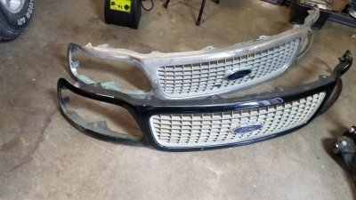

Good news though, the 1/4" spacers got the wheels out just enough to clear the calipers. I also got the grille changed out, and it looks WAY better. I'll be painting the center piece too, but just not yet.

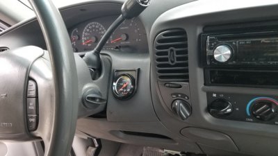

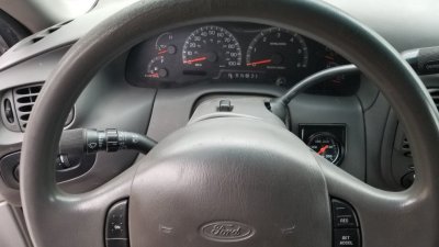

Lastly, I had a buddy drill and install my trans temp gauge while I was working on the wiring harness, and he didn't realize the black bezel was for mounting, not part of the gauge. So I guess my gauge has a nice trim piece now :happy107:

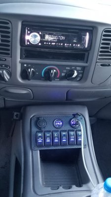

Got a couple more things done to the truck today. I got my sweet switch panel mounted up first. I used a piece of rubber to block off the hole that's created by cutting the whole front of the cubby out, and it's all powered with the key switch.
Next I got some front lights hooked up to match the switches. Bumper lights to go with 'fog lights' and some LED Cherokee headlights I had laying around wired as high beams only to go with 'spot lights' on the switches. Roof rack and more lights come wednesday and she'll be on the trails this weekend.
